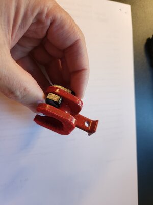

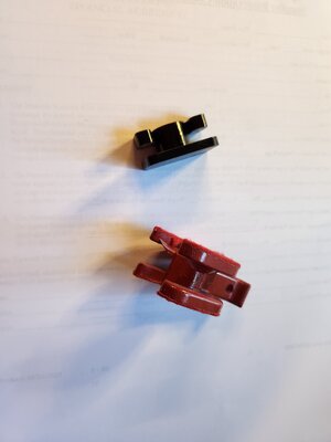

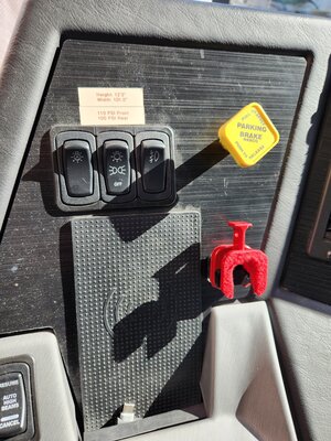

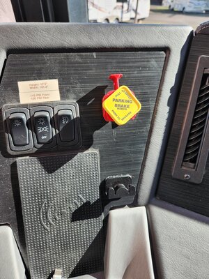

We have a small dog (Cavalier King Charles Spaniel) who loves its momma perhaps way too much. So much so it'll sit on the counter next to the TV Lift so it can watch outside the slide windows for momma's return. However, a couple of times on our Blink security cameras, I've watched her take running double leaps from floor to seat to top of the dash; once she didn't quite make it and pounced on the dash with her front paws as she stopped and propped herself up to try to look up over the top of the dash. How much force does it take to press the Air Brake Release as the little one decides to pounce one of its paws into in? Not caring to conduct that experiment in real time I found a solution online, made some modifications to fit my rig, printed it up on my 3D printer, painted it, added some felt to it as to not scratch the dash, and then installed a holder for it to the dash with some double-sided tape.
I found a 3D print online for both the air brake release stopper and a holder for it (created by a user by the name of CeptoRider on printables.com) for something that could be slid in between the Air Brake Pull/Push lever and the dash. Unfortunately, it was modeled after an air brake lever that had a much narrower gap between the handle and the dash when engaged than what I had on my 2023 New Aire. I downloaded their 3D STL Model, edited it using Fusion 360 to making it thicker, but just barely enough to slide in and fit within the gap between a pulled-out lever and the dash on my rig. I've uploaded to printables.com for others with Newmars with similar dash / air brake handle designs.
