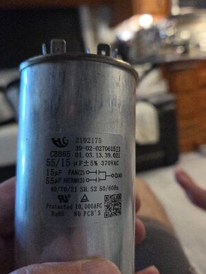

No the Microair easystart regulates. It has you remove one capacitor and ptcr...this allows it to regulate locked rotor amperage. You still have an original capacitor in the unit. Has three ports. Common, Hermetic, Fan. It is a dual value capacitor, one mF for Fan, another mF for Herm (compressor). Look on the label... 15mF/50mF ??? Can't recall exactly. It will be listed in the Parts List for the unit of you download it.

@Neal - I am pretty sure that the easy start only replaces the compressor capacitor. The fan capacitor remains and continues to function. So sounds like the fan capacitor is bad.
Start/Run Dual Fan/Hermetic capacitor. The easy start acts like a regulator. The fan not spinning up, means the 15mF part of this can is shot.
