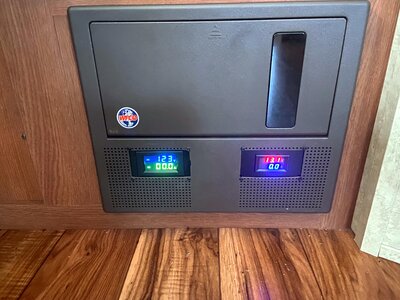

I have added a digital voltmeter and digital ammeter to my power distribution panel for both the AC and DC sources. Kinda nice to look down and see why the lamps are dim or the pump is running slow. Another easy do-it-yourself project with a cost of about $35 for parts.
If one should choose to make these modifications, be sure to get LED display units and not LCD display units. The LCD unit must be viewed from below the unit. Thus laying on the floor to read the display is not desirable. <grin>
