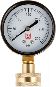

I guess another option could be to test the water pressure and see what it reads and if good remove the regulator. I just bought a pressure tester as we discussed in another thread. Most places a regulator isn’t needed. Only a few have I seen unusually high pressure. The other option is to move your regulator behind the water cord reel inline and not have this issue as well. I personally am not worried about any pressure from city water between the city water hookup and the pressure regulator behind the reel. That hose, if it blows is probably defective and it's not expensive to replace fresh water hose.

BTW my RV has been tested to 60 psi at each annual service at Newmar. I set the water pressure regulator to 40 psi. The last thing I want is to have another experience of a leaking water fittings on a trip. These, as I am sure many of you can attest, can be a pain to diagnosis and repair on the road.

I have seen a few parks over the years where water pressure varied as much as 50 PSI between low and peak use times. I'm just not willing to risk having an issue over something as easy as putting a pressure regulator on the spigot.
As for the pressure gauge you bought, I carry one that looks very similar except that mine only measures to 200 PSI. They are a quick and easy way to check park water pressure. Every RVer should carry one.
I also have a Watts 263A pressure regulator with a gauge on it that I wish I'd never bought. The integral gauge looked like a good idea at the time, but just sits there doing nothing after you've adjusted the regulator. The Watts 263A is a high-quality adjustable pressure regulator and I would buy one again, but without the gauge. Having a separate gauge makes more sense.
