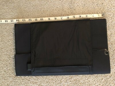

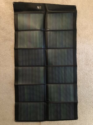

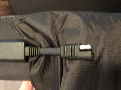

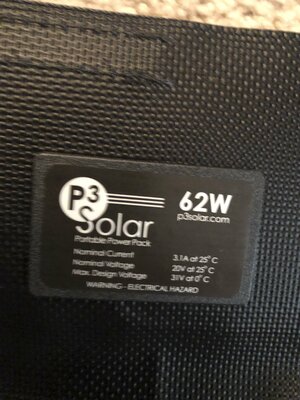

I've used these for yrs.. I'm getting ready to put this on here for sale.. These are amazing I have a few of them. Expensive, but well worth it. I just didn't add them to my RV when I sold it a few yrs. ago and have no need for them.
