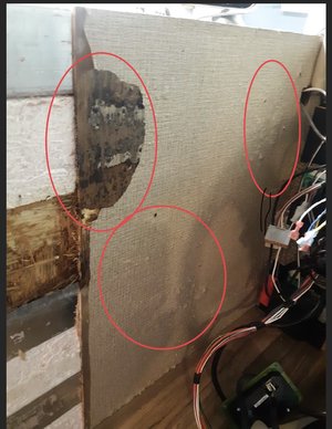

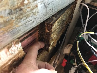

Do you have these bumps under you wall paper on the inside walls, especially under a window? If you do, it’s MOLD! You probably have extensive water damage infused the wall. My 2018 (bought brand new) THOR ACE 30.4 had them under the drivers side window. After removing the window and opening the wall, I found a tremendous amount of water damage. The water got into the wall via the seam cover/channel used to cover a seam from the roof to the window. The seam cover/channel was installed behind the window. The widow was then sealed. This allowed water to have a channel to travel from the roof directly inside the wall where the seam cover/channel meets the window. See pictures.
