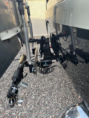

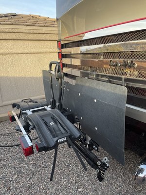

I have 2 folding fat tire ebikes and no longer wanted to put them inside my suv. I wanted a bike rack setup where I could easily move the bike rack from the suv to the rig while on the road and when we know we’re not going to use the bikes for a few days. I decided on the heavy duty Thule Easyfold with a Roadmaster 10” rise adapter. The rest of my setup includes 2 anti rattle clamps, Blue Ox tow bar, Blue Ox rock guard and Roadmaster Stowaway modified to hold the rock guard when not in use. I also made an additional light set for the bike rack for when I put it on my suv as my bikes block a lot of the suv’s rear lights. I’ve tested the bike rack on the suv on some rough roads and have been impressed so far. I also did some clearance testing to make sure the bike rack/rock guard/suv combo won’t have issues with corners and dips behind the rig. I only had to make a small cutout mod to the rock guard. We are in our current park till May 3rd, so the full road test will come at that time.
