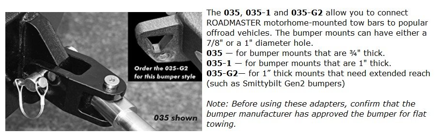

Absolutely YES! The caveat is the aftermarket bumper must be built for towing. I found a Smittybilt winch bumper on sale for $199. An email to Smittybilt customer service with bumper part number confirmed that I could use it for towing my Rubicon. The Roadmaster D ring tow bar adapters are P/N 035-1 (they fit Demco tow bars too).
Not all aftermarket bumpers are a direct fit so there's cutting and drilling involved. A direct fit bumper should be part of your search criteria. The Smittybilt bumper I found is a direct fit. I was able to remove the OEM bumper, added my winch to the new bumper and had it bolted on in less than 90 minutes.
