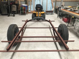

Restoring 1955 Tini-Home canned ham.
Debating on what to use on exterior and here are my thoughts.
Diamond plate on front of trailer up to window.
Aluminum (one piece) from front window up over roof and down back side.
Fiberglass (one piece) for both sides.
Thoughts and or suggestions?

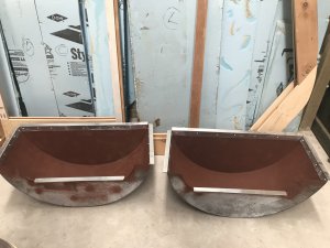

Just started cutting out new or repurpose pieces to duplicate the side frames. Will use Kreg Jig to fasten. Thinking of gluing also, good idea?

I have the same question as @Kevin D Pem; "restore or rebuild?" A true "restore" will use the same materials as the original, and in the same configuration. The idea would be to make it like it was when it was new. "Rebuild," OTOH would be to make the unit fully functional once again but not necessarily the same as it was when new. Either is an admirable goal, but each would take a different direction.
It is hard for me to give much meaningful feedback without known where you want to go with this project.

Just started duplicating New frames for both sides. Kreg Jig and glue? Keep it the same as old one but may add an additional window on curb side.

Heres the deal, I like standard frame spacing that way it is easer to make the cabnets. Won't add much weight. Second note is The restoration you show is not painted per original. They did two tone back then but it sure looks great and it matters little.
By the way the cabinets are part of the structure. I used a one piece roof. Oh let me explain, I assembled the inside roof with rafters and plywood. It makes it easer to keep the walls aligned so when the tin goes on all will align.

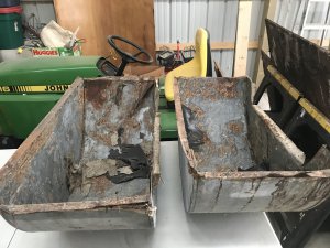

Just started building the frames (sides) today.
The road side wall had 2 vertical 1x3’s. Once I get the perimeter put together and windows framed, I will add more 1x3’s. I’m with you on standard frame spacing.
