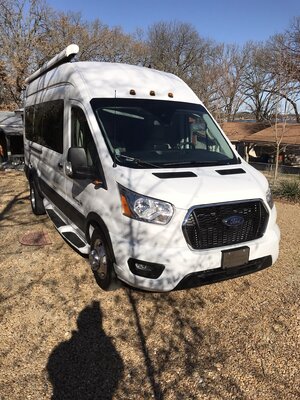

Are there enough Beyond owners to have some good Q&A discussions? Wife and I just took delivery of a new
22c awd li3. The coach was purchased sight unseen out of state from NIRVC. The dealer did a great job on the PDI (pre delivery inspection) and delivered it 800 miles to my house in Texas. The entire transaction was very smooth & professional from order, closing (all over the phone) to delivery. The only short coming was not getting a good detailed delivery walk through. Coachmen does not have a actual unit operator manual. There are factory installation operators manuals for most of systems but you have to know enough about what you are looking at to know what you are looking at. To our good fortune most everything is working after a lot of trial and error. This li3 lithium power system is incredible. Coupled with the truma furnace/water heater we have survived a few nights In the 20s temp. Have a few questions for later.
