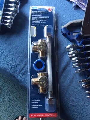

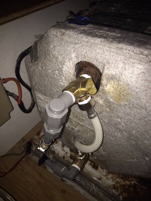

I fixed that by reversing the lines, and also replaced the by-pass valve kit as they were allowing water to get past the stop valve no matter what position it was in. Still no hot water from faucets. (yes bypass is in correct position)

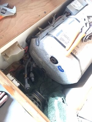

On hot water tank, I disconnected top water line (with bypass on until I was ready), and the hot water tank was still full, and I turned on pump, and then opened bypass valve to allow hot water from tank to flow out from top valve.
I was definitely getting good flow and nice hot water from the top output. But when I connect the plumbing line, I cannot get hot water from the faucets.
HOWEVER, when the pump was turned off, there was still enough pressure in the tank from being hot to push some water out, and the water from sink faucet was HOT only with the pump off (from sink faucet) and turned instantly cold when I flicked the pump on.

Hi Kev. I have a B Eng and have designed systems much more difficult than 2 bypass valves ;-) I was trying different combinations as requested by another user. Here is what I found:
  • there is cold water from hot water faucet with bottom bypass valve in bypass and top valve set to tank
  • with bottom set to tank and top set to bypass; hot water flowed out sink faucet without pump on but turned cold with pump on
So bizarre! Originally, the cold water line was going to top of tank so I changed that to the bottom...

I was able to contact previous owner. he by-passed some of the plumbing lines under the RT because the hot water faucet was leaking at the outdoor shower faucet. Would have been nice to know this before I cut the lines at the tank because I was getting water from the top line, so I reversed them, and then spent over 2 weeks troubleshooting, installing new bypass kit, etc ....
