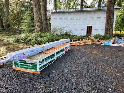

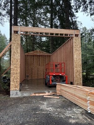

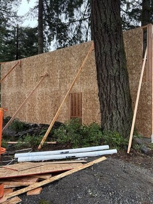

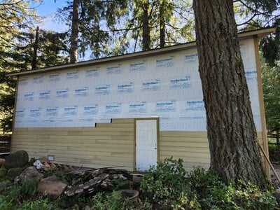

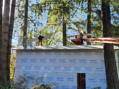

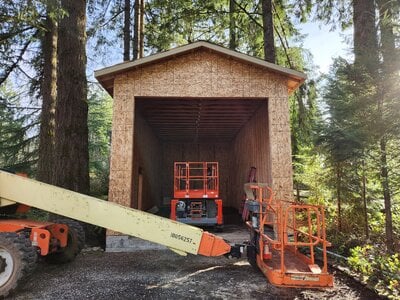

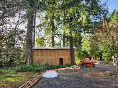

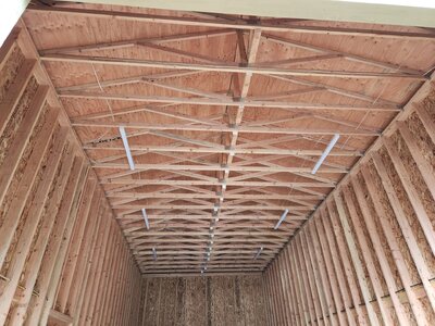

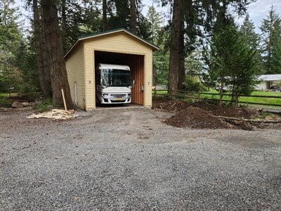

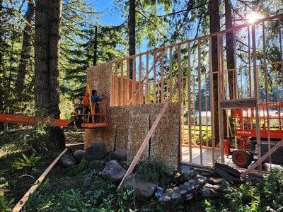

Nice work on the header.Today's update. Last of the rough siding and the start of roof trusses.

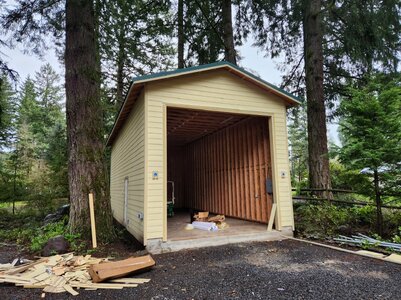

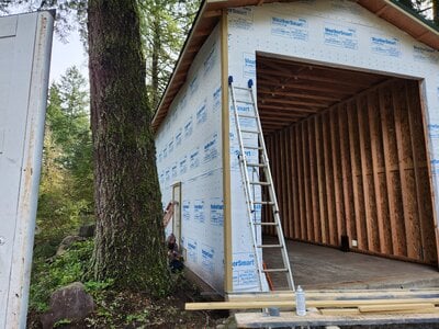

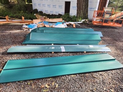

The Hardie Board over Tyvek on OSB is a good choice for your climate up there.After spending a week in D.C. where windchill brought temps down to -1° F, imagine my joy when I landed in Portland at 9PM and it was 50°F outside. Then the next morning I saw they had completed all the rough siding and roofing. Next comes metal roof, hardie siding, doors, electrical, and paint...

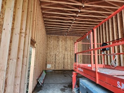

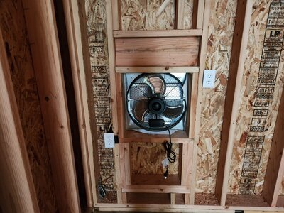

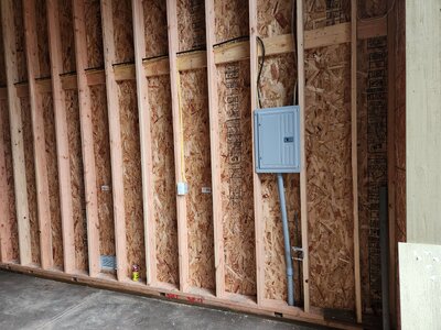

Good point! I will go check and, if not, install a solid wood backing block behind there to secure the inside of the back of the box to. That, and swap out for a metal box. Easier for me to "just do it" then to call the electrician back. Thanks!Is that 50amp receptacle anchored to the back or just the side? And a plastic box?
Plugging and unplugging can place a lot of stress on a side stud mount.

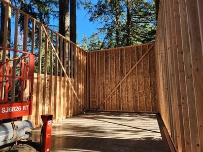

Mine is the same. I am told six inches should be good. Of course I am less than 22,000 lbs.Yes and no. Yes in the foundation footings around the entire perimeter, but not in the 6" slab itself. I guess we will find out how that turns out for me down the road.
