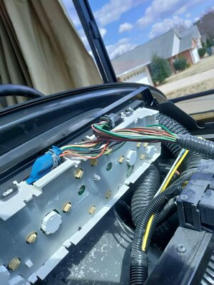

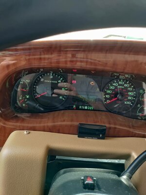

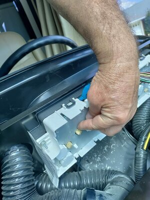

I found this solution to the problem of not being able to see the gauges in the dashboard gage cluster on my 2013 Winnebago Vista 27N.......I purchased (on Amazon) the T5 Nanpoku super brite 12X T5 74 73 37 27 21 LED Cluster indicator lights "white" for $6.99. You get 12 led light bulbs and my gage cluster took all of them...I am 100% satisfied with the brightness and visibility now...Not sure if your RV takes the same bulbs though..for $6.95 iyt is worth the try. If not you could resell them to someone who owns a vista 27N...
