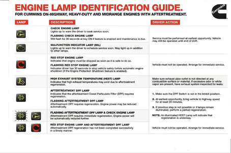

Here is a question I have, and it may only relate to a Spartan Chassis ... my DPF regen process has happened about four (4) times since we have had the coach (about 15,000 miles on it now) and each time the cycle lasts about one (1) hour. So far it has always finished, and the light goes off before we reach our stop for the night as it usually happens when we are on an interstate.
So here is my question ... what if we reach our stop before the cycle finishes? Is it ok to just shut off the engine and hope it will finish when the engine is restarted the next day ... or should I leave the engine running until the cycle is over? For example, what if the regen process starts 10 minutes before we want to stop.
Just want to be ready if this ever happens to me. FYI, I posted this question on the FB Newmar Owners Group and am getting very mixed responses ... kind of like the jacks down/slides out/what comes first question.

A REGEN only requires about 1000 RPM, it's all about maintaining a temp. If it were me, doesn't matter the chassis, I would not turn off the engine until it's complete. It will just be in a high idle until done. It could take an hour. Just don't park over dry grass or leaves or be in a fuel lane.
I can't remember if it was Spartan or Cummins. We were told to leave the engine running. You could park in a clear area, no tall grasses, etc. So far, every time we've exited the highway at our exit, before we've reached our actual stop, the regen process has shut itself off. We've seen it pick up again on the next highway trip. Hope that helps. For further reassurance you could confirm with Cummins after the holidays. As you said you get all sorts of answers on the forums.
Either way is fine because as long as it senses enough differential pressure between the inlet and outlet of the DPF it’s going to start a regen as soon as conditions are right (engine rpm, road speed, and exhaust temp). So if its in the middle of a regen while you're at highway speed and you interupt it by getting off, whether for fuel for 30 minutes, or overnight or longer, and it has not burned off enough soot, it will start again as soon as conditions allow. Spartan may be saying “keep driving” to be on the safe side, but it isn’t necessary.
What you don’t want to do is continue to drive at low speeds (under about 55mph) for an extended period of time (more than a couple hours) because at some point the system will give up trying to regen and put you into derate. This is from the system designers to keep you from ignoring the issue, potentially damaging your DPF, and of course causing permenant injury to the planet, just like the low DEF issue. I’ve read you have as much as four hours to perform a regen once the lamp illuminates, but as @Neal recently found, this can sneak up on you pretty fast. It shouldn’t and I don’t know why his did - I would have said it wouldn’t and been wrong.
All that said, I’m a firm believer in the more regens the better, and I have several adjuncts to perform them manually. So if its at all feasible, I’d give it the opportunity to finish a regen any time the sensors initiate one, although I would probably not pass my exit and just drive until its done, because I can easily perform a manual regen. As far as I know, it can’t finish an active regen on its own once you stop. Maybe Spartan added this feature, but I’ve never read any accounts of a regen self-initiating when parked - it will always wait until driving conditions are right again, or for manual initiation if parked. It can’t detect if you are in a safe location so by design, it won’t start on its own unless you are driving.
There are three stages or regen: passive which is just the process of soot burning off in the DPF when exhaust temp is high enough (around 700°, no dash indicators, no diesel injected into the exhaust), active which includes the injection of diesel while driving (1100° +, high exhaust temp, still no DPF lamps on unless you slow down or stop), and parked/forced/manual regen (they may even be other names for it but its all the same thing) where the operator finds a safe place to perform a regen and has the time to sit for an hour or so, and initiates the regen either by a switch on the dash (truckers), the “shorting plug” (FL chassis coaches for a number of years - not sure on new ones), or with an external device that plugs into the J1939 port and has regen capabilities. But Spartan may have devised and installed other means for the operator to start a regen - I don’t know.
