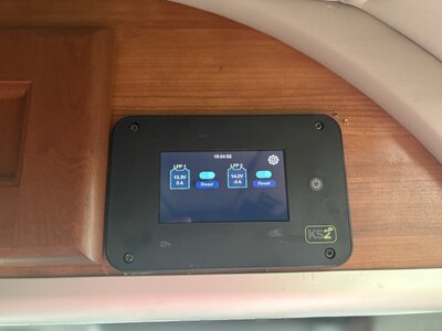

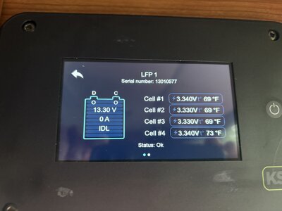

Sorry for the late reply but if you need more information on current battery condition, I installed the KS2 battery monitor. Works super for looking at each cell in each battery for volts and charge condition.
Not cheap but it’s easy to install as a plug and play replacing your rocker switches. Slight trimming for the face plate but not bad
