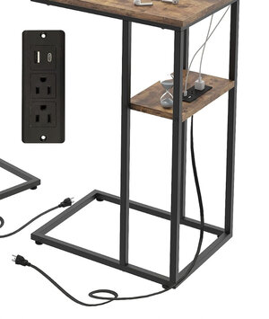

Question Electrical experts - can I safely use this C table with outlets?
Can that one outlet support a tablet, a phone, and a coffeecup warmer?
I have a great spot at the end of the sofa, next to the coffeemaker 👍🏼 and I'd like to use this table for my tablet, maybe phone, and add a mug warmer (on second shelf). Would this be safe?

So it can run a lot of stuff. The thing to rmemeber is that its probably not a home run to the panel so there are likely other outlets on that circuit. Turn off that breaker and see what else is on the circuit. Then do the math (total load in watts divided by 120 to get amps) and you’ll know how much total load you can put on it. A 15amp breaker can theoretically power 1800 watts, but you should keep the load under 80% for a safety margin, so just make sure that the total load on that 15amp breaker adds up to 1440 watts or less at any one time.

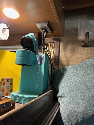

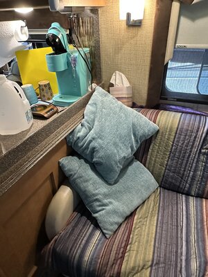

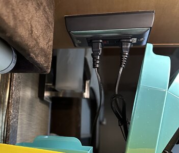

this is the table in question and my cozy coffee corner where I sit in the morning and do computer stuff. Coffee maker is plugged into one outlet, but the other one is where I was thinking to plug the table. I need the mugwarmer plugged in usually, and the ipad and phone only occasionally (if I forgot to charge). The outlet is difficult to see and reach, so I'm trying to figure out a way to get around it. I'm even thinking of a plain 'unwired?' table for the other end of the sofa if the first one works out.

As stated by others tablets and phones are low watt devices. Coffee warmers would burn the Coffee if more than a couple hundred watts. That would translate into a total load of under 2 amps at 120vac, on a minimum 15 amp circuit.
That is not enough to warm the wire!!!
So it can run a lot of stuff. The thing to rmemeber is that its probably not a home run to the panel so there is likely other outlets on that circuit. Turn off that breaker and see what else is on the circuit. Then do the math (total load in watts divided by 120 to get amps) and you’ll know how much total load you can put on it. A 15amp breaker can theoretically power 1800 watts, but you should keep the load under 80% for a safety margin, so just make sure that the total load on that 15amp breaker adds up to 1440 watts or less at any one time.
Yes, the coffeemaker and warmer might be a lot. Good suggestion - will try it out.
yes, a coffee maker can easily use 1200 watts, a Keurig is more like 1500. So if you find they are on the same circuit, just time your loads accordingly - don’t run everything at once, although the phone and tablet chargers draw so little that they really don’t factor in to the equation.
