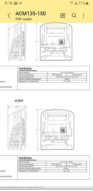

I copied and pasted my earlier reply to Red Baron.'I will have 1 2-outlet inverter to supply 2 AC plugs for up to 500w. I MIGHT also add a single outlet 1500-2000w inverter for a rooftop A/C (ASA AC135/AC150). MIGHT.'
When as you say you "plan to have 2 large special batteries". They'll need to have the capacity to run that rooftop a/c for a time, unless you have a method like the Evotrex to auto replenish energy to the batteries or unless you're planning to plug up to a pedestal.
