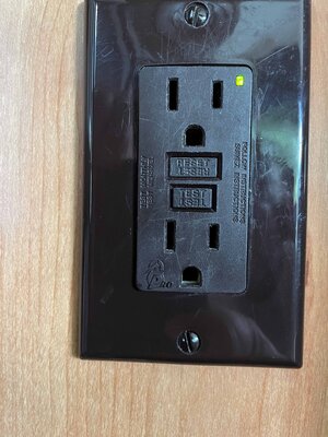

Depending on your unit you may have a number of ground fault breakers. They almost look like a regualr socket but they have a couple of buttons and should also have an LED to show they are armed.
Mine are brown so difficult to see but they come in normal socket colors as well See the pic Press the reset.
