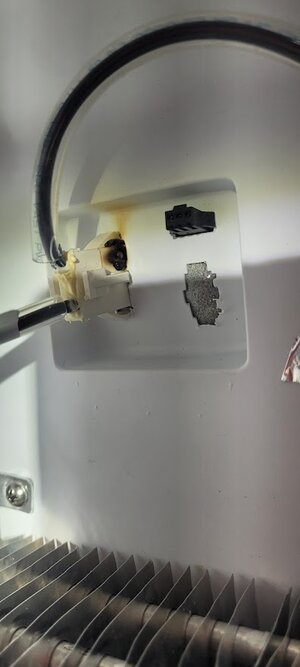

The original company was bought out by Lippert which also bought out furrion. Currently I have problems with a refrigerator that is only 14 months old, I am not a full timer. Kyle Flack from Furrion/lippert just informed me that they do not have a service manual nor do they know the specs on the refrigerator part.
Why would anyone spend over $ 1500.00 for a refrigerator that cant be fixed.
Luis
Currently it is not defrosting and I have a burn mark on the connection of the heating element. See attached pic.
I have not been able to take it apart since I am still on the road having to defrost the refrigeration every 5-7 days
Not sure if its a loose connection, bad thermistor, bad heating element. The confusing thing is that even though it has a burn mark it has never taken the fuse. I am hoping that its just a loose connection and that I can get to it.

That certainly does not look good....If it burned up, it would not cool at all, unless you are running on propane. I would not use it on electric with that burn mark. You are correct that the thermistor can cause it to frost up. . Also correct that you need to know the ohm range at x temp to test it. All the RV makes have their naysayers, we have worked on all brands, except Everchill......also called never chill..seems yours is over chill.
Is there a movable thermistor in the freezer? Or is it controlled by buttons? Also, frosting up tells me it is getting moist outside air inside. Check your seals by putting a dollar bill in and close the door. Pull the bill out to check for tight seals. Not sure about Everchill but he drain plug on the back is supposed to have a plug in it with small holes. This keeps some water in the drain and prevents warm air from entering the fridge and causing problems.

Yes there is a thermistor in the freezer. It is cooling on 12v. It does not have propane.
Do you think that the burn mark is due to a faulty connection? Can a bad thermistor "get stuck" and overheat the heating element?
What controls the defrost cycle?. Mother board, temperature or a timer which I have not seen?
If I cut and cap the wire to the heating element will the refrigerator work and can I use it without the defroster? Knowing that I might have to defrost manually on occasion.

Phew, lot there. I have no parts to an Everchill. So this is a 12v only fridge? The burn marks are certainly not because good things are happening. No a bad thermistor will not over heat the element. There is no defrost cycle that I know off.....I have not worked on 12 vdc fridges yet as they are new and I have not seen a bad one but have heard they suck. Also, the 12 vdc fridges are running a compressor and do not use a heat element so I don't know what is going on with that. If you want the best, get a residential fridge that will fit in the hole nicely, wait for the new shine to wear off the 12v craze and they are proven to work, and if that does not work go back to the old absorption style fridges that everyone seems to hate.

Looking at your photo, it looks like maybe you have a failed connection. You could try to remove the male and female connectors and hardwire them together to test if that is the only problem you have. A failed connection could be the result from another problem, but splicing the wires would be a cheap and easy way to test things.
