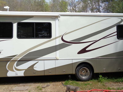

Couldn't find the "before" pictures, but rest assured, the decals were really bad! Here are a couple pics, first one is after I painted and was removing the tape. The other one is after it was finished. Only took about 8 hours over a couple of days.

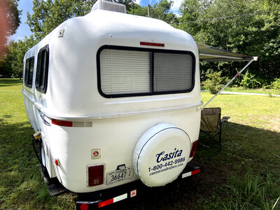

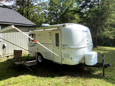

When we purchased our used Casita..........well it looked like the first two pictures. Some folks, I could just never figure. After it was all said and done and with much tender love and care, it looked like the 3rd and 4th pictures. It can be done with enough patience and "elbow grease".
