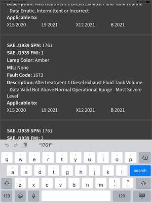

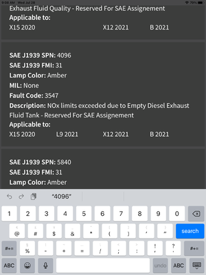

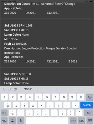

Just had to pull over right outside of Memphis. Low DEF and check engine light came on. DEF was 3/4 full. Fault codes were 1569 fmi 31, 1761 fmi 1, 4096 fmi 31. We turned off the engine Started it again the codes are cleared there are no messages and no codes. Can anyone tell me what these were am I OK?

Hope your travels are uneventful for remainder of trip. When you get a chance you should get the Spartan Connected Care app which gives the diagnostic codes I attached here. Also the contacts for parts, support and service centers and much more.
