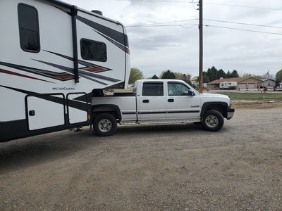

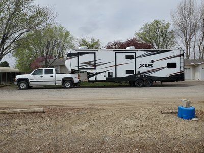

Don't know if this will help or not. Mine is mounted with the ball toward the cab and the pin connector mounted with the ball socket toward the front of the trailer. The ball is in the lowest position on the frame. I have not had this setup long but so far I have had no problems. According to Anderson's instructions for the Ultimate, you do need to lock out the Rotoflex pin box.
