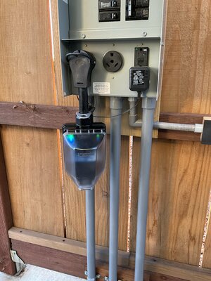

Have been having an odd electrical issue in the last 24 or so hours. Have been in this campground since Saturday with no issues. Then starting early this morning, we realized that we had been losing our shore power. What it appeared is that something (low voltage?) would cause my Southwire Surge Guard to kick off and then start the 2 minute delay. Since we have an inverter, it was hard to notice since the only thing that happens is the heatpump or electric elements on the oasis shut down. What clued us in is the "beep" that comes from the induction cooktop when the power returns which happened after the power returned. You could also hear the "thump" of the transfer switch. Note: I have a the Surge Guard paired with a Hughes Autoformer that are installed in my basement. This is our first outing with this arrangement although I had used both before.
The first thing I did was test using a dog bone and 30 amp. The problem went away for over an hour... So we had the campground check the post. The electrician (County park) came out and replaced both the 50a outlet and breaker and said there were issues with loose connections and old breakers. After that point, we were good for the rest of the day on 50a.
But tonight the problem returned. I have checked the following:

I have spent a lot of time staring at the precision circuit display watching for fluctuations. Didn't see any and it has been rock solid on 122-124 volts on both legs. Even when under load.
I am beginning think my Surge guard has become flakey and over zealous about fluctuations in power. I do not remember how old it is, but I figure it is at least 6 years old, but less then 8. Remember we do not travel all that much so although it has some age, not a ton of use.
Do you guys agree? We will be heading to another campground on Sunday where I may plug this thing in again and see if the problem follows the device or the campground.
