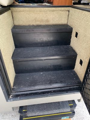

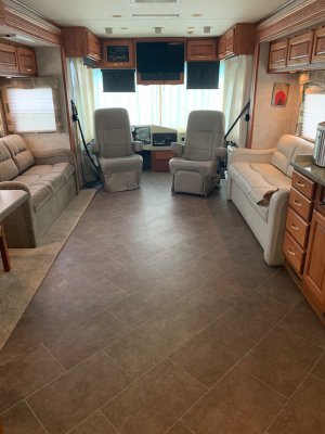

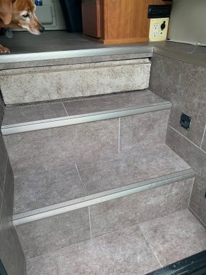

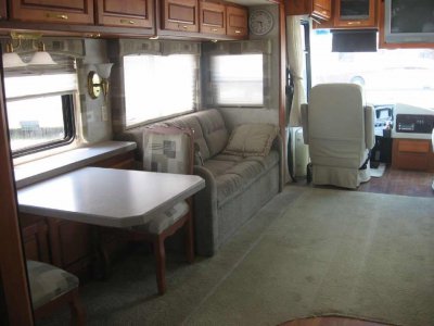

We just had our floors completely re-done by Classic Coach Works in Ormond Beach FL. They did an excellent job! We had a luxury vinyl tile product that looks like tile installed throughout. I even had the entry stair well completely redone in the tile. It looks amazing compared to what we had before. The original off-white 15 year old carpet looked HORRIBLE!! And the cheap stick on wood floor product someone used looked just as bad. We kept the carpet on the drivers side front slide but upgraded to a very high end carpet that is guaranteed not to fade. We also had them rebuild the captains chairs with new closed cell foam and cover them in matching ultra leather. They can do just about anything you can imagine. Check them out at www.classiccoachworks.com

I wanted shiny ceramic tile with heated floors built in. Classic Coach Works would not do Ceramic Tile (like all the new high end coaches have) because he says his customers were not happy when it started to crack from the chassis flex as you have described. This is why we went with his recommendation of the luxury vinyl tile or planking if you wanted wood floor look. This stuff is HEAVY!! It's very thick and I doubt it will crack. Classic Coach Works has been using it for about 12 years now with excellent results. I'm sure a cheaper product would do exactly as you say. I'm also sure the quality of the product they used in our coach was the reason for the $8000 price tag (including the entry steps and walls). I guess only time will tell. But I fully expect the new flooring in my coach to last as long as I own it. I'll report back occasionally to let everyone know how it's holding up.
