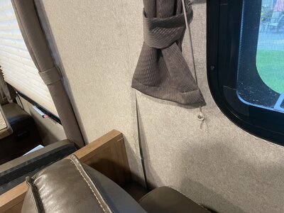

I have a 2018 Forest River ROCKWOOD ROO 24WS and recently the interior wall bows out when I pull the large slide in the whole way - see attached pic.
Has anyone had this happen to them and what is the fix?

Are you talking about the wall in the slideout? If you are, is the bowing near the actuator underneath? What I’m thinking is you’re pulling the slide out in too far. I would think there is an adjustable cutout switch somewhere that might need adjusting.
when the slide is run in and it is almost in, the moment you hear the motor go under stress turn the switch off. I never trust the switches.
Is it the whole wall? Kind of looks like just a little trim piece. I have a piece like that on my trailer that's coming away from the wall. Just needs more glue or some very short finishing nails.
Yes, its the whole wall and only does this when the slide in brought in the entire way - it goes back to normal when the slide is out
