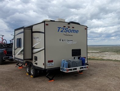

I have the same camper.
I have an aluminum gear rack (Harbor Frieght) on a 2" receiver on my bumper. I carry a Champion 3400 watt generator on it. Also, I modified the rack by shortening the hitch post to bring the generator as close to the bumper as possible.
Because of the extra weight, I installed:
Quick Products QP-SBSBU Standard RV Bumper Support Brackets​
I bought them on Amazon 2 years ago.
This system is working well so far.
That is mounted to your bumper?? What are the bumper support brackets mounted to?
Quick Products QP-SBSBU Standard RV Bumper Supportn Brackets​
