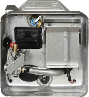

This is the same. When I put the gas heater on, it doesn't want to start. I didn't hear the click click. I opened the outside door of the heater and there isn't fire.

I'm sorry, I assumed you had the ITR OASIS system. I see you have a 2002 model. I'm not sure what model heating system you have. My apologies.
Does the stove light? If it does then you've got gas flowing. Next check for lockout mode, if it has failed to light after 3 attempts it's in lockout. Turn the switch inside to off, wait 10 seconds then back.on, listen for the click.of the igniter. Check for any obstructions in the burner tube, even a cobweb will interrupt ignition. Next check the thermal cutoff, a clear plastic tube covering a small wire near the combustion chamber, if the unit overheated this acted as a fuse and blew. If it appears blown short the wires, if it lights that was the problem. Next check the electrode ( the ceramic insulated probe) for carbon buildup or cracking. *** make sure the water htr is full of water before any of this***
