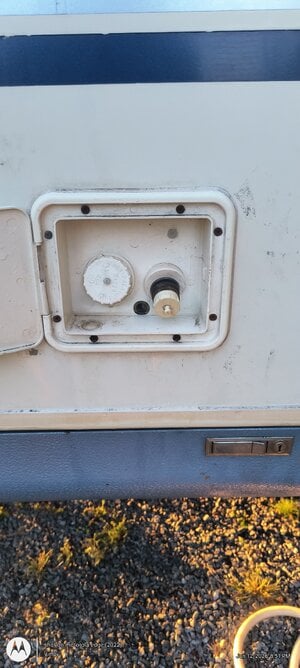

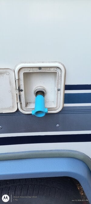

Hello. New to this site from the beautiful state of Washington( highest gas tax state). I recently purchased a 1993 31' tow behind Holliday rambler. I've been able to go through and fix the propane, lights-inside and out. I'm having issues with filing the fresh water tank, before I sanitize it. While filling the tank with a hose, the water comes out of the hose connection fitting right next to the fill hole. Water is also coming out of the overflow tube under the trailer, long before the tank is full. How do I fill the 38 gallon water tank without water coming out of the hose connection and the overflow tube?

Thank you all for the replies. I'm still confused as to why it's there a hose connection next to my manual fill? I have a city water connection about 6' away. 2 City water connections? I've never heard it seen that before.

I may be way off but it looks like some one rigged a fitting (brass) for blowing out the system to winterize.
Are u 100% sure the fresh tank is empty? Have you opened the drain? Try opening yhe drain and then turn on the hose to fill it. A good flush may help.
