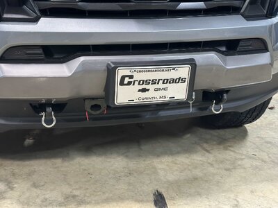

In a previous post I mentioned I sold my 2008 Jeep and 2017 Nissan Titan XD for a 2024 Chevrolet Colorado ZR1 that is flat towable. During the winter months I got it ready by wiring the tail lights, battery shutoff solenoid, and power outlet for the break system.

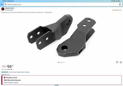

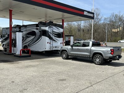

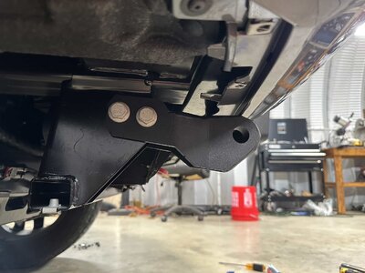

When I looked at the baseplate for my Blue Ox toe bar I was shocked at the $400-$500 price tag, plus having to remove the entire front body work to install it. Looking at other options I found tow hook shackle mounts for $66 and tow bar adapter for $45. It worked perfect and did not have to remove the front body work. I took it for test drive and tows beautifully.
Heading out Thursday on our way to Martinsville for the race.
