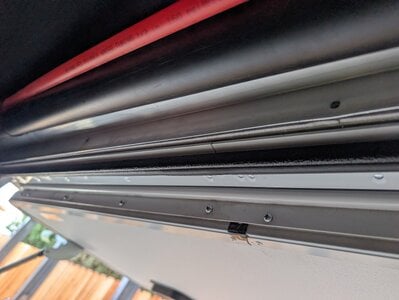

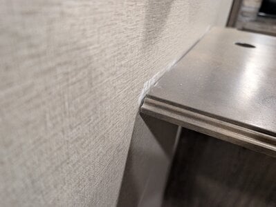

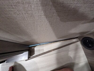

Right side of kitchen slide is out 3/8 inch further than left side. Wall appears to be bowed a bit causing kitchen counter/bar to detach from wall and floor trim to fall between wall and floorboards into storage bin below! You can see daylight through the floor gap! Also, the entire row of screws along the top/interior of the door jamb in the 2 storage bays below are missing.
Can we just do the resync the motors tip I've seen online to fix it... "pull in 6 inches, let motors full stop, then extend until both motors stop, repeat 2-3 times until both motors stop together"? Will this bring the wall back flush with the floor, so we can fix the interior and replace the screws in the storage bays? Is it something more serious going on to bow the wall or is this common? What would cause this motor asymmetry to occur? How can we avoid it in the future? Thanks for any help you can give us!
