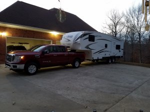

The Nissan Titan XD will pull the smaller light weight 5th wheels. There are between the 1/2 ton and 3/4 type trucks. Mine is a 2017 gas with a 7 speed transmission and the bed hitch and electric brakes are standard. I believe the new ones are now 9 speed. Now if you are looking at working across America making frequent stops I would like to think a motorhome might be a good Idea? Less work in setups.
