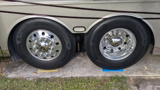

Jimmy did agree that the steers are at the time to consider replacing but also said he'll change the rear tires if we want but at less than 6.5yrs old he'll inspect them this summer. If they look good like I told them they do he suggested we could get more time out of them. We were ready to replace the rears but he actually unsold us on replacing them at this time!
The tires look great so I'm going to get more time out of the rear tires. There's a bit of scuffing on the tags but not a single defect on either side or treads of the tires that I could find. Here's a picture of the rear tires I detailed last November and they still look like new. Oh.... my exposed side steer tires look as good as the picture below

I am of the camp that wants to keep tires going while they still look good and have regular inspections.
We just replaced all our tires at 8 years old, only because we WERE going to sell the rig, but changed our mind and decided to keep it.
At 8 years old, outside and inside (checked insides after they dismounted the tires), upon CLOSE inspection, the tires were in great shape and believe we would have reached 10 years without any issue.
Happy to see your tires are doing well!
