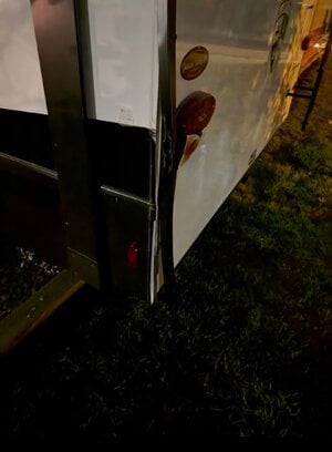

What is the trim for and an you give us a couple different angles that are not too close?
Back driver corner trim. This does not have the vinyl insert most exterior trims have.

If it were me, I’d by a standard aluminum angle trim from a hardware store for however long you need for both sides. Paint it and use butyl tape on the inside to seal it. Then screw it down.
