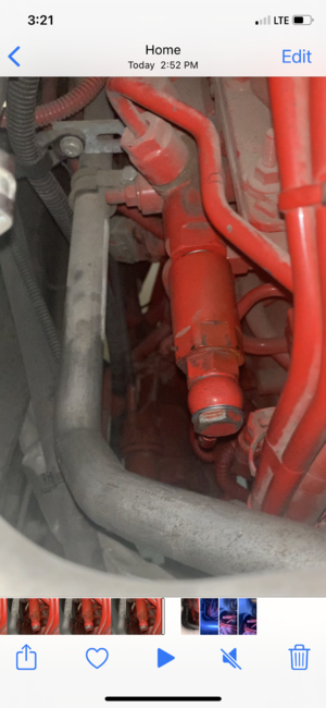

I had the recall done this morning. From start to finish I was there about four (4) hours. I think they did the majority of the work from inside the coach through the engine access hatch. They did do some work from the back and underneath but maybe that was just checking for leaks.
I had partially removed the engine hatch (the tile part) and all they had to do was remove a couple bolts from the actual metal cover underneath the tile. That way there was no chance of breaking the tile or damage to the inside of the coach. This was a suggestion by @redbaron
Attached is a picture of the fuel relief valve which I think is where they put the new washers. It is on the end of the engine closest to the front of the coach on the passenger side. So I’m glad that’s behind me.
