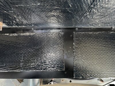

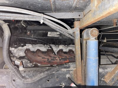

You can put heat shield material, but it would be hard to attach. What I did and testing next week is I built a barrier between the engine and wheel area, kind of like a wheel well. It’s basically a 2ft by 4ft piece of sheet metal to block most of the airflow. Hopefully this will direct the hot air back and downward.
we shall see.
Here is a picture of before and after.
One shows the entire side of the engine exposed to the wheel well.
The other shows the panel installed. I did add sound deadening material to it. The demention is 1ft X 4ft. Not 2ft.
