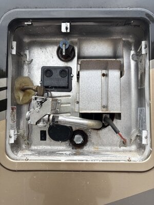

Two-part question regarding hot water heater.
1. Turned hot water heater switch on and not getting hot water (electric mode). Any trouble shooting tips appreciated. I did check the breaker and also, it's not in "bypass" from winterization. There is no hot water at the pressure relief valve.
2. It appears that the water heater is setup to run off of propane also. I have never fired it up that way. How is propane ignition accomplished?
Attached is photo of unit in 2019 Newmar Ventana 4037.
Thanks!!

Do you have a switch to turn on the gas portion of the heater and is it on? What have you tried?
I have never run the hot water heater with gas. I did figure out it is a Suburban SW10DE and order a new heating element. I was hoping I could find out how to fire it up using gas.
There should be a switch to turn on the gas portion of the unit...
Is the gas valve open to the water heater. igniter that fires that gas

My Ventana (older than yours) has 2 water heater switches next to each other on the panel above the entry steps. One switch turns on the electric, the other the propane. Neither were marked well when I bought mine used.

Propane systems usually have an electronic ignition system. It is basically fool proof. If you system valve is supplying propane...and you've purged the line. We used to do that by turning in a stove element. But basically you turn it on. It thermostatitcally turns on and off on it's own. If it has a fault...it will safely shut off. You will have to turn it off and back on to clear any faults. Here's the catch. If you haven't used it...spiders love to build webs in the mixing line. Before bringing it back into service...it might be a good idea to pull the tiny cutter pin to remove the mix tube..and I spect or blow out with compressed air to blow out any foreign objects. Reinstall and pin. If it lights up ...you're good to go.
Another weak spot of these systems is wind. If you have gusty winds and they blow up the exhaust opening, you may experience a flame out and fault. Same with propane furnaces.
Hope this helps.
Have you pressed the reset buttons? One side is for 120v and the other one is for 12dc............Ya need to get a meter out and check for voltage before tossing part's at it........That plastic cover that has the 2 reset's on it comes off..........check for power at these safety switches.......
There is a switch in your picture that fails often. It is on the lower left side. It is actually a breaker, not just a switch. It has 120v at it so shut the power off if you remove it. the spades will short out against the case when you pull it out.
Guys I get the "stupid" award for this one!! I turned the switch for the gas on not the electric switch. DUH!
Everything is working as it should.
