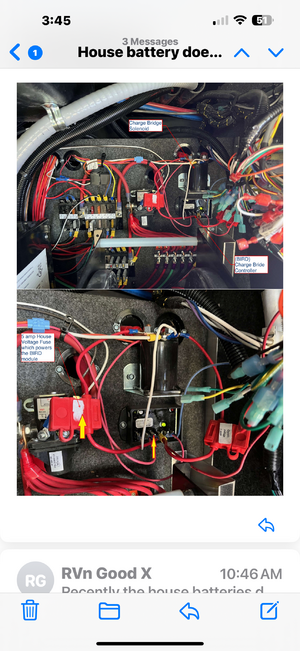

Here is Newmar suggestion. There are two 5amp fuses in the power locker that run the solenoid. I’ll try to see if one is blown.
Verified both 5amp fuses good. Might be forced to take to local dealer. Not looking forward to that!

The interesting part is it appears that the chassis and house batteries do Bridge via BIRD circuit.

Had a great experience at Independence RV. Tom was the service writer. Appears that when Newmar swapped the BIRD at Tampa Show, the wires got swapped. Batteries would not properly Bridge.
