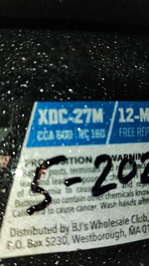

I have an external 'tray' behind the genset which holds a single 27M group battery. I just got the coach and haven't pulled it out to really take a look. Here's the best pic i was able to snap with 3 bends of my wrist in ways it was never designed to go :D I'm fairly sure that it says CCA 600 and RC 160, but might be wrong. Based on the marker that's cut off in the pic, it's a 2022, so fairly recently replaced.
It's from BJs wholesale club and branded that way.
seems the re-sell interstate.
So, this is the closest thing i could find for interstate:
wrong colors, but the CCA and RC line up.
so, it's likely an 88ah battery.
