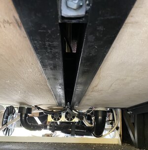

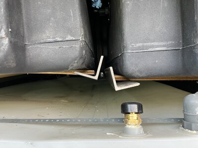

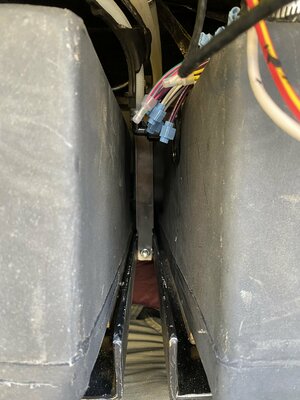

Current state of the tank bay. Its ugly but the good news is that I found a local fabricator to make new mounts and if all goes well the thing will be back together by Tuesday afternoon. Until then its back to camping which Im finding relaxing and pleasant. Fortunately I’m visiting with family that has some helpful facilities in a community that has some resources. Things could be worse….
Well Humpty Dumpty is back together again. I guess its a little better than original however I can not recommend this particular upgrade as its not worth the effort and under normal conditions there is no reason for it.

Now that is a tank support!

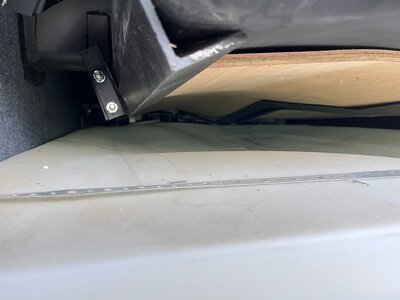

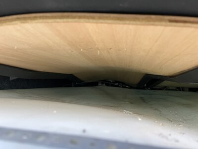

2”x1/4“ angle iron - pretty stout stuff. While I was in there I cleaned up a lot of wiring and plumbing mess (they are a little sloppy at the factory in the areas you cant see) and also dried out the wet bay. Apparently it got wet at some point in its life so having the tanks out gave me a chance to really clean it up.
I also added some 3/8” marine mahogany plywood for the fresh tank to ride on. Unnecessary I guess but it was nice to upgrade the space. So its all back together, a little better than orig, and the coach smells better (fresher) so I guess the wet bay was getting kind of froggy. All better now. But wow - a lot of work getting there…..

yeah, my best side….Here’s another: the happy repairman. I spent a lot of time working in the 4’x7’, 14.5” high space under the black and grey tanks, with just my feet sticking out, measuring, prepping, and installing the new supports. Not fun but I have many hours training and working in such spaces (confined space rescue, firefighter survival, etc).
The fresh tank is now supported slightly above the carpet with an air space so if water gets in there it will have a chance to dry out and prevent possible mold and odors. one of many little improvements I made while in there. I also learned a lot about what is behind the wet bay panel and how all that is assembled. I cleaned up wiring and plumbing on both ends and improved the alignment of my dump valve outlet.
I also added some 3/8” marine mahogany plywood for the fresh tank to ride on. Unnecessary I guess but it was nice to upgrade the space. So its all back together, a little better than orig, and the coach smells better (fresher) so I guess the wet bay was getting kind of froggy. All better now. But wow - a lot of work getting there…..View attachment 13353

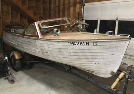

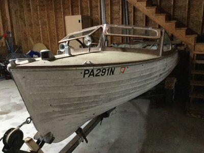

Hmmm, I really like the old boat in the back of the first pic.....Lyman?
So, on mistakes. I just had to pack up and move one spot due to misunderstanding my departure date. No big deal - more than I would ever pay for a one night stay anywhere. But ego bruised. I guess none of us has yet reached perfection.
Your tepair looks better than the original build. “You got talent”.
Yes, thats my ‘58 16.5’. First year of the “walk-through” front seat - major innovation! Its in need of restoration but has no rot and everything is there including hard to find stuff such as windshield opening hardware. Its a real gem just waiting to move up on the project list.
