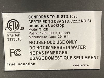

It is probably fine, I just use extreme caution after @MapNerd's event where he lost all power due to a blown inverter fuse. I now have 3 spare fuses and hope to never use one. When I use the air fryer I typically plug into the induction cooktop plug due to the fear from above scenario but last time I did use the under cabinet plug (inverter side) and it did fine. Be aware of electrical loads. Know the ratings which are probably on the underside of the cooktop but I'm too lazy to look.
So @Neal What size breaker is the induction top connected to?
What part of lazy was unclear! Fine, I'll get out of my chair...
It's 120V / 1800W on a 20A breaker.
This is "my" model induction cooktop, different coaches have different models, dual burner, blah blah blah.
