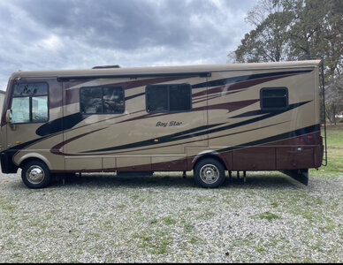

I’m currently living in my 2011 Newmar Bay Star 2901 at Myrtle Beach, SC. It has been in the upper 30’s at night. My coach has a heat pump. I set the thermostat on “AUTO” on 74 degrees at night. The temperature is comfortable in my bedroom, but it’s probably 15-20 degrees lower in the rest of the coach. I’m not bothered by the heat pump turning on/off, but I’m freaking cold when I get up to use the bathroom! I have the windshield curtains closed & all window shades pulled down. Other than a space heater in the main room, how do I keep it from getting so cold? All ideas are welcome & appreciated!
