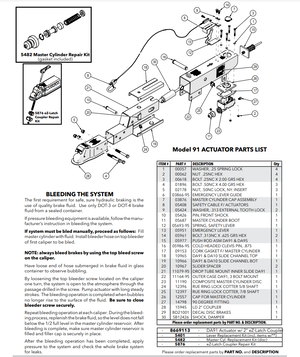

After 23k miles and three years or so of use it is time to change the brake fluid. Typically I use a pressure tool to move this process along as I work alone. Not sure how I can flush this system solo. Any thoughts? demco brake bleed.png

Ask Demco
Demco, Dot 3 or 4
Demco, Dot 3 or 4

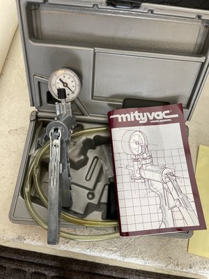

Kevin, thank you for suggesting the vacuum method. I have had this MityVac tool kicking around my shop since the 80s. An important tool for when I bled the brakes of the road racer, weekly:) Haven't touched it for 20 years or so. IMG_5596 (002).jpg
