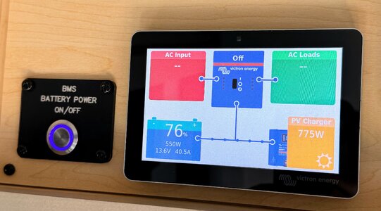

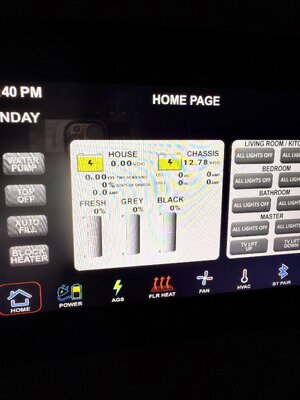

On my 2024 DS 4081 the Victron Energy touchscreen monitor shows house battery voltage charge level of 76% charge level / 13.6V while the KIB panel shows 0 voltage. I suspect the issue is almost certainly a blown sensing fuse or a disconnected communication wire rather than an actual dead battery. The fact that the Chassis battery still reads 12.66V on the KIB panel suggests the panel itself has power, but it has lost the specific "link" to the House battery bank. I am thinking this is a blown fuse. Can someone suggest where to look for the blown fuse? I've "reset" the system several times turning off house batteries with no success. TIA

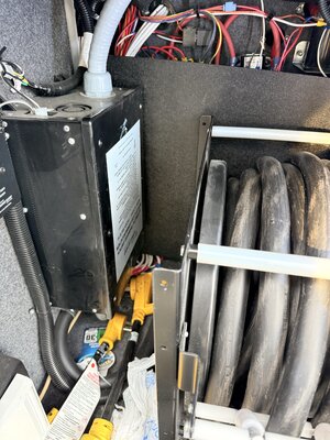

I tried accessing the fuse panel in the electrical bay. Newmar must have installed the plastic shield prior to installing the cord reel and transfer switch. There is no way to get this out to access the fuses. I’ll be working on getting this plastic cover out to look at the fuses.

That shield is just held on with Velcro. At least that’s how mine is held in place. You should be able to wriggle it free. I took mine off several years ago and left it off with no problems.
That looks like the transfer switch in my coach and the cover just snaps on, and I don't think there were any fuses in there just contractors. But I wasn't looking for fuses.
I notice your tank levels are zero also. Are your tanks in fact completely zero? I have been fighting an ongoing issue with my 2025 LA. I don't know if your systems uses any Silverleaf components in the background that you are not aware of. My issue has been bad crimp connectors on TM1000 module. I suspect there are other problematic crimp connectors throughout the data wiring. Mine is based on RV C. Has green and yellow wires for data. The TM1000 controls charge bridge as well as deciphers tank levels and shore voltages. It also deciphers data from the inverters which give out the house battery voltages.
Good question on tank levels. Since the RV is winterized tanks are empty so I don’t really know. I haven’t had a chance yet to call Newmar to see if they can help.
