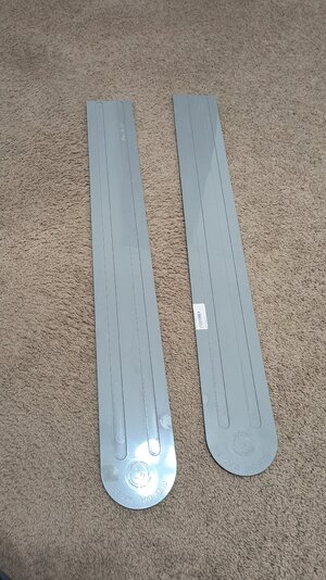

After waiting a month for the dealer to contact me, finally called them and they mailed a pair of Slide Out Slickers. You put them under the slide out before closing and then remove them when you put the slide back out.
Seems more like a band aid as opposed to a fix. This is the first RV we have had, all of which had laminate floors and slide outs, that the slide out put dents in the floor. Seems to us it is more of a maladjusted slide out more than anything. On ward and upward.
