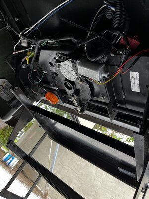

You most likely stripped your half moon gear, very common. There’s also one another type of gear in some of the lippert steps. I did my own. Keep it greased, clean and don’t let people step on those when they’re coming in and out. See below photo,also I added electric Killswitch. It seems that switch in house, constantly turning off by accident. And steps go in and out when the door opens or close as I get tired of it specially when camping for long periods. Can’t disable for manual use, can disable so it doesn’t open by pulling the wire underneath attached to motor.
