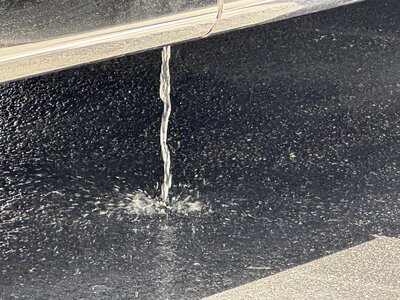

Picked up a load of bad water, brown color. Drained and flushed tanks and appliances. 12 hours of chlorine solution.
Water a pain.
All better now!
