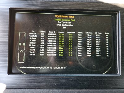

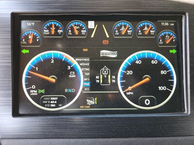

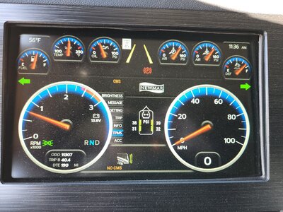

I have yet to get Spartan's TPMS display to work properly on my 2023 Newmar New Aire Spartan K2 chassis for my TOAD vehicle. I purchased the Spartan TOAD TPMS wheel sensors (through the dealer), had them installed (through Les Schwab as the dealer didn't deal with TOAD tires), configured the Spartan TPMS settings to tell it that I have a TOAD vehicle and the serial numbers of my sensors on my TOAD vehicle, and...it can never find the sensors. It also sometimes loses connection with the rear tires on the passenger side.
I have seen other threads mention that the placement of the Spartan TOAD antenna used by the TPMS may be at issue and that some have even had 2nd antennas installed even to read the rig's tires properly let alone those on the TOAD vehicle. That said both my dealer and local Spartan service centers (Portland, OR area) haven't really been helpful (both--we don't do TOAD tires).
If anybody does have this working, I'd love to know. Also, anybody know where I can find the TPMS antenna Spartan / Newmar did install? I assume it is between the frame rails in one of the bays, but don't feel like removing panels between the frame rails in the basement to go hunting...
