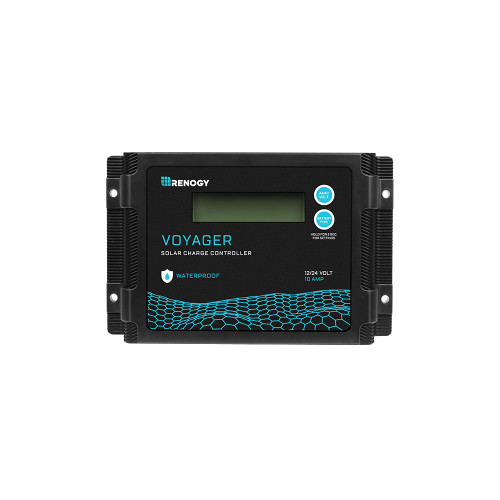

This isn't specific to Forest River campers, but on my very small, simple Palomini travel trailer I have a 100W solar panel. With a new 100Ah AGM battery (not yet used - just installed on camper) the controller reads FULL (13.6V) and yet the Ah reads from 1 to 2. Can anyone explain what's going on here? I do have the correct battery type chosen. Thanks
