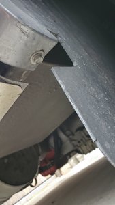

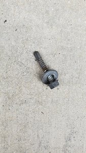

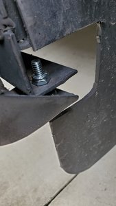

Driving on a trip, I heard a flapping sound outside the coach. I saw in the mirror that the rear of the front fender had come loose from it's attachment point at the bottom. Upon inspection, I found the screw missing. After losing that one and re tightening others several times, I decided to do a permanent fix. The lower fender bolts that secure the bottom of the fender to the frame rail are tek screws that are self drilling and self tapping. Nasty little buggers if they come loose and can put a nice hole in your tire when they leave. I removed each one and drilled them out to 1/4" and installed 1/4 20 stainless bolts with nyloc nuts. One more thing off the list...
