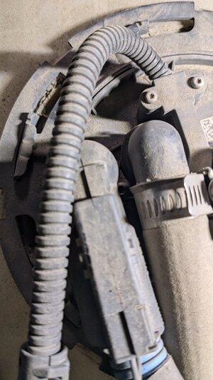

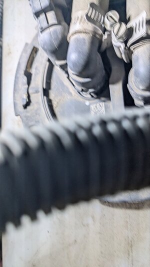

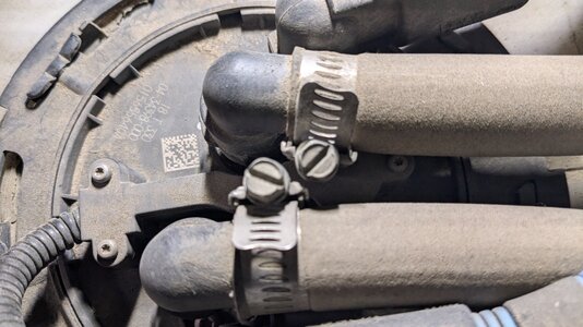

It’s not the DEF head that is acting abnormally it’s the valve that controls the engine coolant circulating through the head. When it fails it fails open which can then cause the head sensors to fail and then all hell breaks loose with engine warnings etc. if I don’t need heat circulating through the head why even chance it. I’ll leave the valve closed for now.Yep, that should work.
You might want to leave it open and let the DEF header operate normally, and then upon failure you could use the valve. That way you would have an emergency "get out of jail card" to use until you can find a 4th replacement header.
But either way, I'd say your ahead of the game!
